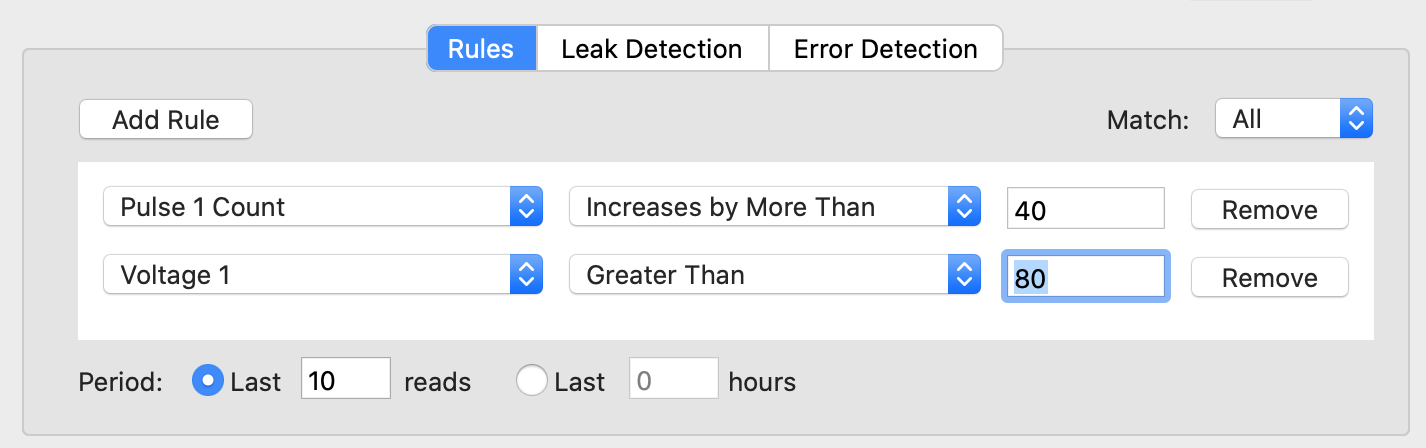

Will you send me a screenshot of your trigger setup in your Dash software? Are you triggering based on pulse counts? Or on watts? Your screenshot that you sent with the dropout was a graph of watts.
It sounds like pulse counts, so maybe you can add something like volts, because when you have a dropout, I assume all data (such as volts goes to zero as well, but Im not sure without looking at your data). So I would try something like this:
So in this case the voltage would have to be above 80 volts AND the pulse count would have to increase by more than 40 within a span of 10 meter reads for the trigger to fire. How does this idea sound?

It would seem that all is solved: I do get triggers that are valid now and no zero reads anymore. The solution that you suggested works fine as follows:
1.) The zero reads disappear when the wifi connection is improved e.g. to moving my laptop closer to the router. Somewhat surprising as the list of parameters that gets read seems to contain otherwise valid data and the zero reads occur largely on the same measurement "voltage 1" or "pulse 1" mostly. With poorer internet connection one would expect random/garbage, but this is not the case. Yet the improvement by moving closer is clear as all reads were stable and valid for days.
2.) Unfortunately this is not quite practical for me. So another solution was suggested which is super simple. I have attached an example, which exclude zero reads by inserting a rule that the count needs to be greater than 10, :shock: :lol:
