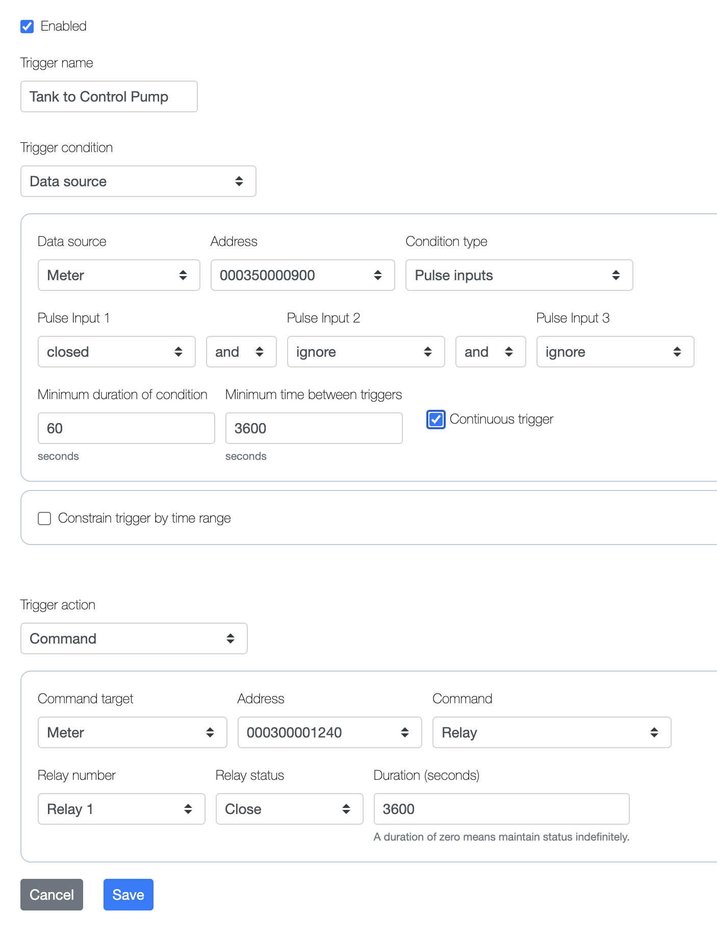

So in summary yes, you could have your Omnimeter near your storage tank be connected to a float switch (connected to one of its 3 pulse inputs), you would then monitor the Pulse Input states and trigger based on their state (see screenshot for an example of a Push3 trigger), you would then control the controllable relay outputs on a different Omnimeter. The controllable relay outputs would be connected to a larger relay, contactor, or solid state relay which would power/un-power the pump.
This screenshot of a Push3 trigger shows how the pulse input state of one Omnimeter can be used to control the relay outputs on a different Omnimeter:
