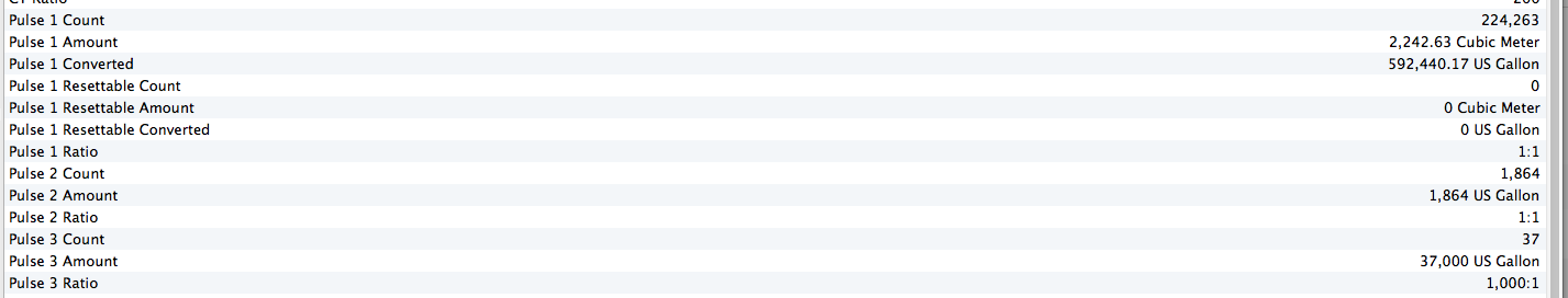

The first thing to check is to see if your v.4 meter is still set to a Pulse Input Ratio of 1000:1. If this is the case it will take 1000 pulses from your gas meter to increment the v.4 register by 1. In a lot of cases we recommend setting your Pulse Input Ratio to 1:1. Do you have a RS485 to USB converter or an iSerial so that you can make this change?
Here is a screenshot from my EKM Dash that shows Pulse Input 1 and Pulse Input 2 set to 1:1. It shows Pulse Input 3 set to 1000:1
