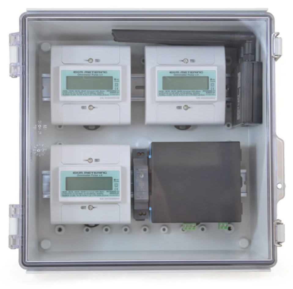

Will the following modules fit in the EKN-303015 UL Enclosure?
2 Omnimeter-1-V3
1 EKM Push=3
RUT240 Cellular modem
12V Din power supply
2 ethernet cables bringing in signals from 2 water meters and 2 gas meters.
It is hard to tell since the Push3 does not show the mounting direction.
Re: Space in EKM0303015 UL Enclosure
Yes, you should be able to fit all of that equipment in the XL enclosure. This attached image shows an XL 303015 enclosure, with 3 x Omnimeter Pulse v.4, 1 x DIN rail power supply, 1 x EKM Push3 gateway, and 1 x RUT240 Cellular modem installed inside, you should have space to run the CAT5 cables and ethernet cables you need, with space left over.
