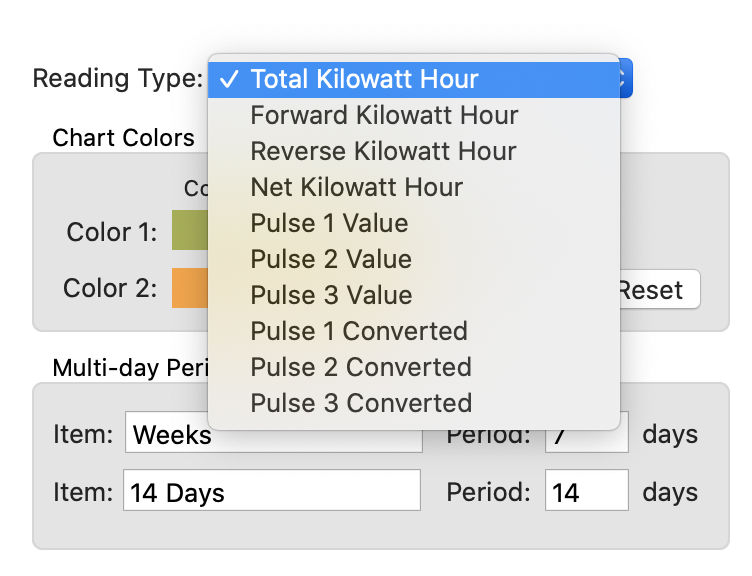

I have everything connected now, using the pulse output from the Intellimeter BTU meter in addition to the electrical monitoring. The electrical side registers flawlessly on the Dash software, but I just discovered a little note that says that the pulse data from the Thermal meter cannot be displayed visually on the Dash software??? What are the chances that this could be a little update for Dash? The client does not want their data on the cloud, and so they have isolated the system from the internet, so I can't use Encompass for this purpose.
Is there any other way of extracting totalizer figures from the kwhr register and also the pulse counter register so that the client can monitor energy usage? This was the whole object of the project, and I need to deliver something!

In your EKM Dash software. If you click on "Show Dashboard" in the upper right hand corner, then in the Comparison Chart, you can click "Edit" then in the dropdown you can choose "Pulse 1 Converted" for example. This should show you the converted valued for Pulse Input 1.
Here is a video about how to setup pulse counting in the EKM Dash: https://help.ekmmetering.com/support/so ... ing-video-
