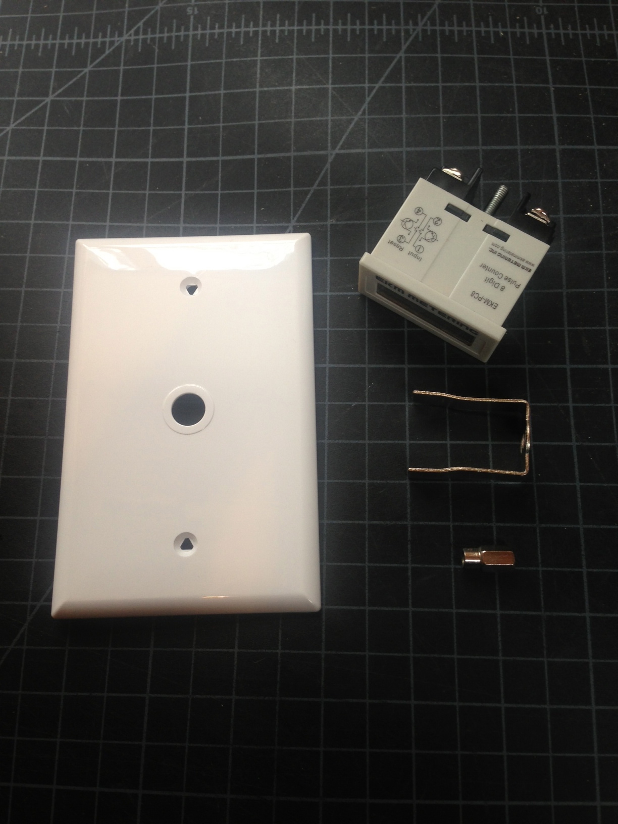

How to mount your 8 Digit Pulse Counter in a standard wall cover plate.
1) Buy a wall cover plate that has widely spaced mounting holes (about 3 1/4" inches apart, not 2 3/8" like a regular light switch cover)
EKM Metering 8 Digit Pulse Counter PC8.jpg (432.81 KiB) Viewed 52543 times
2) Mark the opening you will make. We used 22.2 mm x 45 mm
EKM Metering 8 Digit Pulse Counter PC8-2.jpg (466.79 KiB) Viewed 52543 times
3) Use a router to cut the opening and a file to square up the corners and make the finishing touches.
EKM Metering 8 Digit Pulse Counter PC8-3.jpg (618.59 KiB) Viewed 52543 times
4) Shot of the back
EKM Metering 8 Digit Pulse Counter PC8-4.jpg (535.64 KiB) Viewed 52543 times
5) You could easily fit 2 Pulse Counters in 1 cover plate if you needed to.
