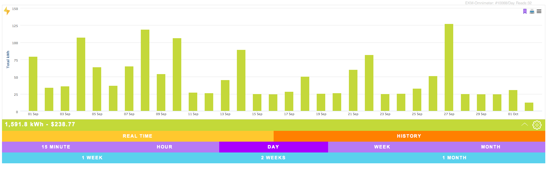

I think the best would be to call Days.
Here is the sample widget that shows this:
http://widget.ekmmetering.com/EKM2/?rea ... _reads=500
I changed reads from 30 to 32 so that you would get the entire last month. You would just have to subtract the kWH from October 1st and October 2nd for now.
In this screenshot of the sampel widget you can see that from September 1st to Oct 2nd the Total kWh was 1,591.8 kWh (in the large green bar). I would just subtract 43.4 to get my total for the month of September in this case.
