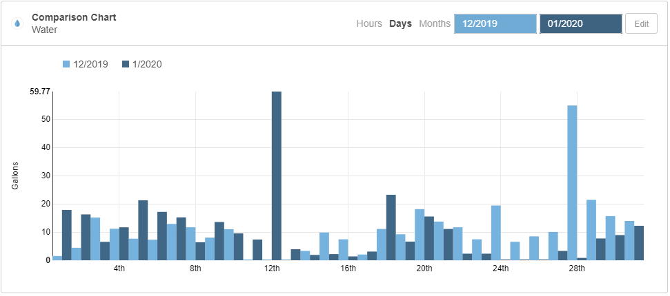

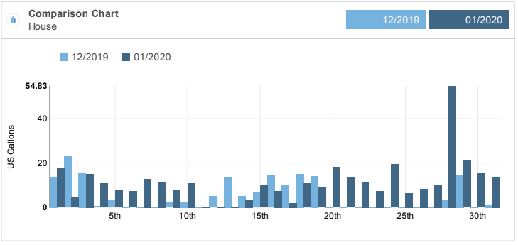

I'm seeing a different issue between the Comparison Chart widget and the report. On the widget, the graphs appear to match the data, but the report shows a very different set of charts. See below.
This chart is from a report that covers 12/1/19-12/31/19 vs 1/1/20-1/31/20.
Here is the widget that covers the same time period for the same meter.
It looks kinda similar for January, but December isn't even close. Maybe the first day of December is different because of the timezone, but I think there's a lot more going on, which should be obvious based on the other differences. The report colors also don't match the legend, but the widget appears to be correct.

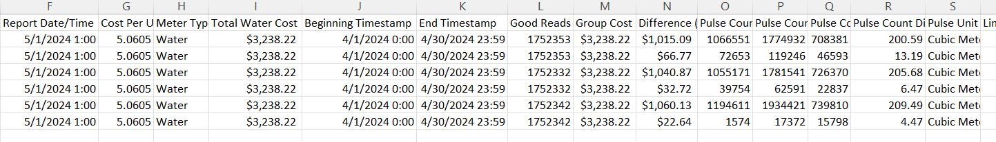

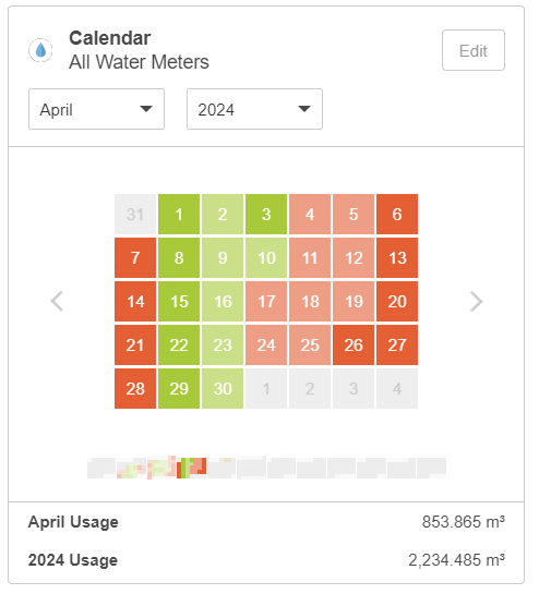

I am seeing something very strange with the widget numbers as well. I have six water meters on a system, the data downloaded for the month of April and displayed on the info widget showed 639.89m³, but the April Calendar widget showed 853.865m³. Looking back, I noticed that February (the installation month) and March were also inflated by ~25%. To make this more confusing, the monthly report showed the 639.89m³ reading, but an upstream water meter that feeds all six, only showed 601m³ for April. What could the calendar widget be looking at to come up with such an inflated number?

Thank you, at first blush I think this may have something to do with daylight savings time, but Im not sure. What is the EKM-Omnimeter number and Pulse Input number you are looking at?

Hi, thank you very much for letting us know. We actually saw this same issue last week, so have been working on a fix. Will you take a look at your calendar widget again? We think we have it fixed.
