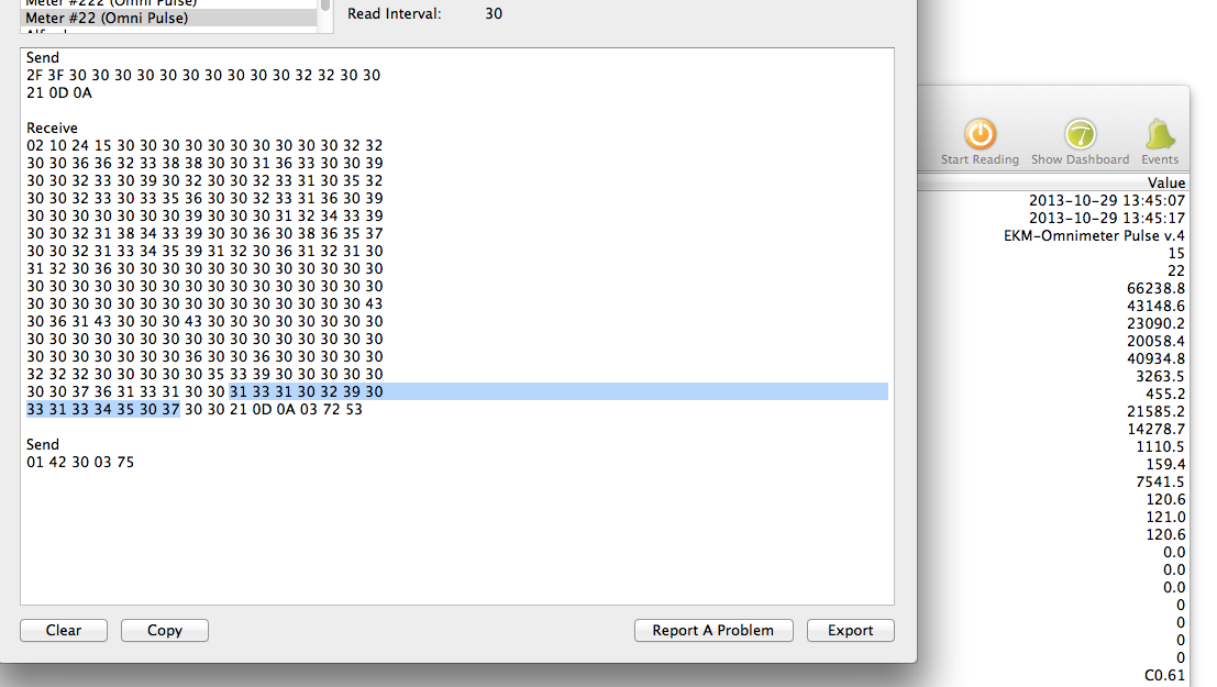

Please take a look at the attached screenshot. This is shows the Dash Hex inspector (with the time highlighted in the Hex) and the date that it has parsed on the right.
31 33 31 30 32 39 30 33 31 33 34 35 30 37
This is parsed as 2013 October 29 Tuesday (3rd day of week) 13:45:07

So those bytes stands for the day of week?
where
30 30 => [00] => Sunday
30 31 => [01] => Monday
30 36 => [06] => Saturday.
Correct?
V. Rublyov
Re: PERL vs SHELL
Yes, that is it exactly 8-)
Well actually, not exactly.
Sunday is 30 31
Monday is 30 32
Tuesday is 30 33
Wednesday is 30 34
Thursday is 30 35
Friday is 30 36
Saturday is 30 37
