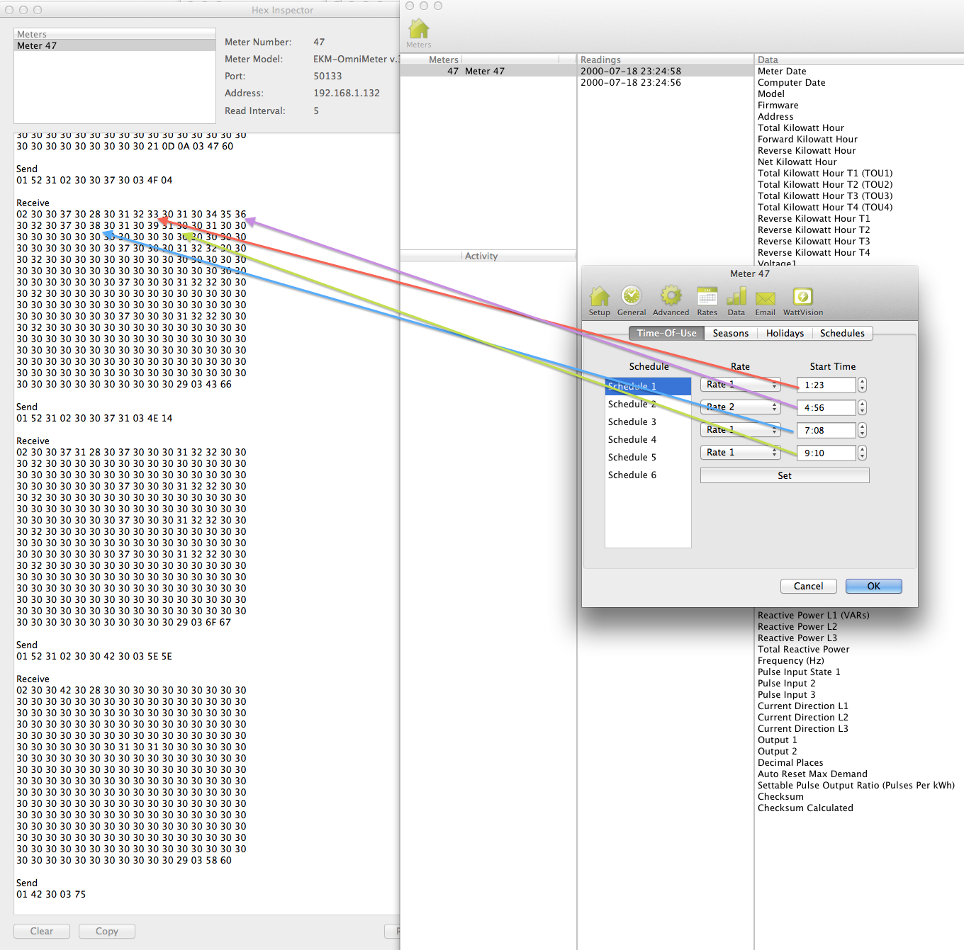

The first thing I would do when trying to make settings in the meter would be to download the EKM Dash software and use the "Hex Inspector" to see how the Dash makes "Meter Settings". With the Hex Inspector window open, try changing the CT ratio of the meter or try changing the Meter Time.

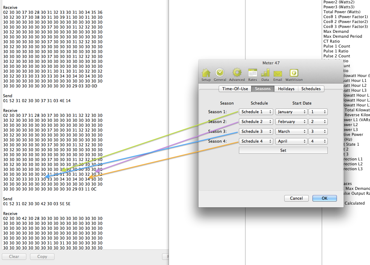

I think it may be best to use the EKM Dash to see this. I will attach a screenshot that shows some of the TOU settings and how they present themselves in the data. I will also show where the seasons settings show up in the data (you can see how I have set the meter to 111, 222, 333, and 444 (where 444 is Schedule 4, April 4th)) Let me know if this does not answer your question.4.) What is the format for the "Period Table" and the "Seasons Table". How are they parsed?

- Time of Use Settings Screenshot.png (462.41 KiB) Viewed 253311 times
- Seasons Screenshot.png (303.58 KiB) Viewed 253311 times

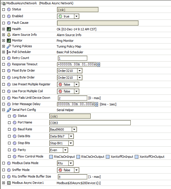

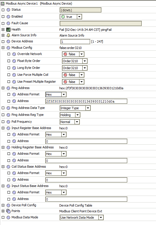

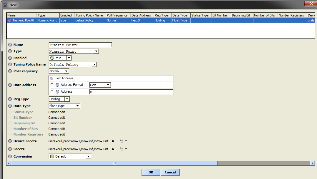

I admit, the content of this discussion is over my head. My goal is to read the data from my v3 meter into a Tridium JACE Niagara-AX controller. This is a very common controller in the building automation market, and it would be very beneficial to me and many others to find a way to share data between these devices. The EKM meter is very cost effective compared to the typical meters that are intended to share data with the JACE controller. I have everything connected on my bench now, and can try suggestions and share my results. I have attached several screenshots for reference. My meter serial number is 16901. Please post with suggestions, and i will test them and share results. Thanks in advance...

Hello ckhome,
Thank you very much for the screenshots!!
We think it would be very interesting to have our meters work with Tridium JACE (we were just talking about this with one of our developers last week). As far as I know, we would (or someone would) have to develop a "driver" that would allow the integration of our meters to the Tridium Jace controller. The driver would let the Tridium controller understand our meter protocol.
I have reached out to a customer that contacted us a while back who was thinking of developing a Tridium driver (to see how it went). Hopefully he gets back to us. If we were to develop a Tridium driver I would be new to the process, so if anyone out there knows the steps to take, to develop a Tridium driver, please let me know
