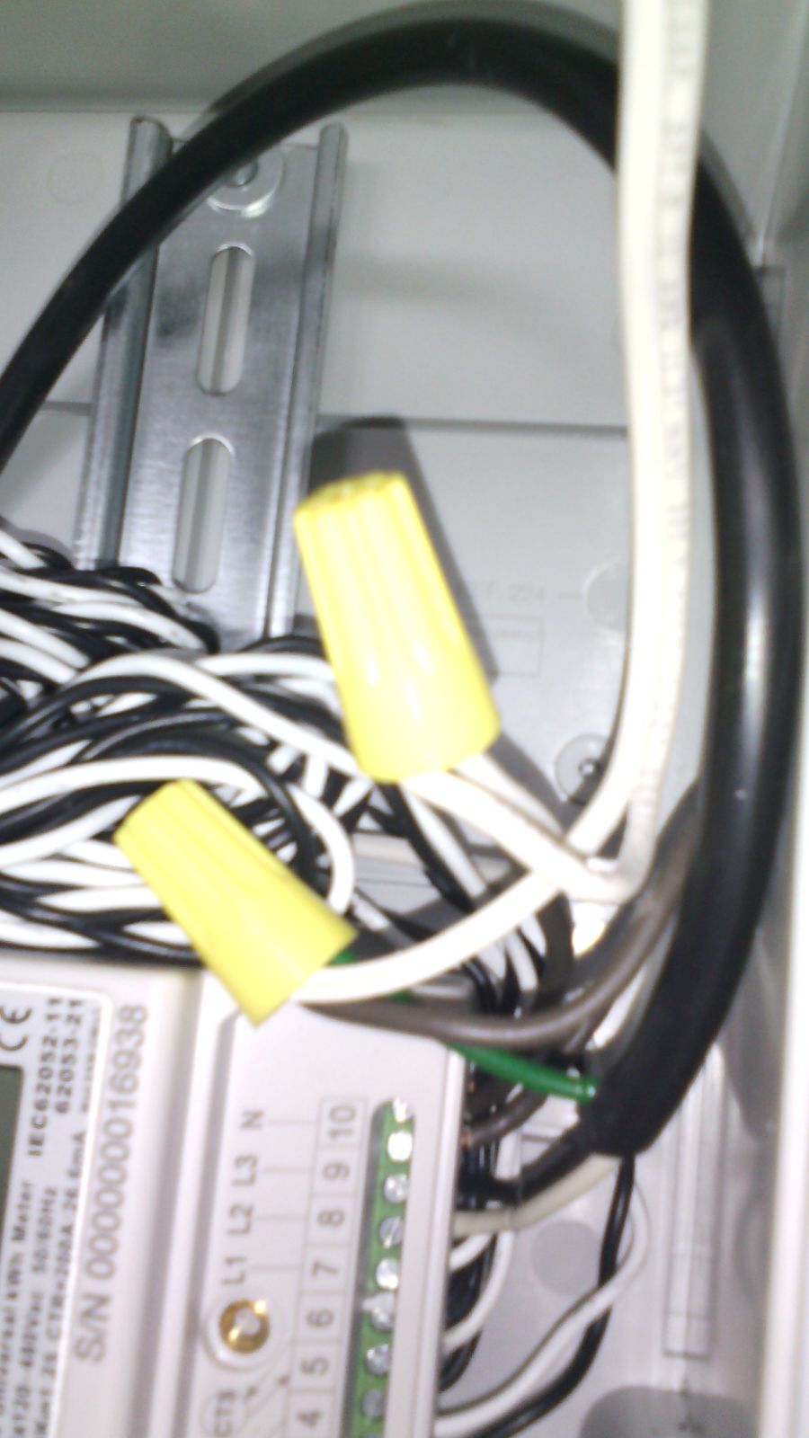

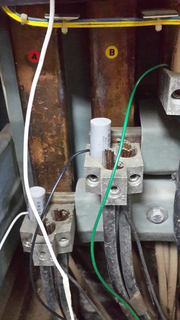

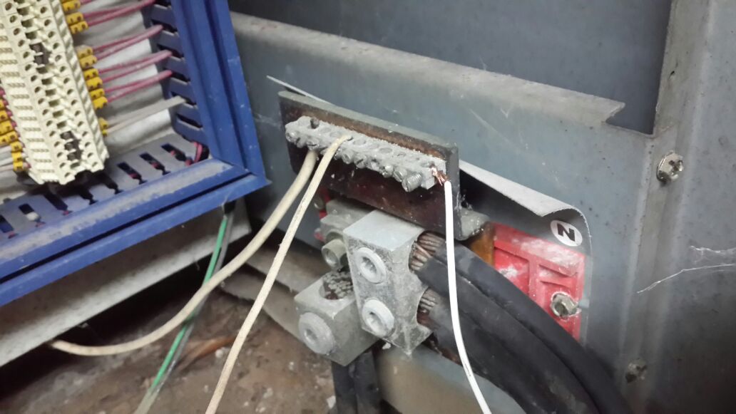

I checked all, and seems to be OK.
We have connected the Push to the L3 and N. Can that cause the funny readings?
I attach photos. We thoroughly checked that CT1 and L1 are the same, as CT2 and L2, CT3 and L3. The arrows are in the load direction. There are no generators on the internal grid.
- AmrHgtdMcqdcc2WV1s4JiqipYyfHpJ7wJZVNQVBGysnr.jpg (77.39 KiB) Viewed 12412 times
- AiY-2L5IvN-G7oOmDExXDy6pjmrZfKnf-H6eMdseOun-.jpg (91.51 KiB) Viewed 12412 times
- AhqlgNoyM2wKbDbeBWA8GdyB4FO9tQmmMsr8D5RpqHfj.jpg (124.92 KiB) Viewed 12412 times
Re: unbalanced reverse
The Push is not able to affect the meter and how it measures power. It only asks the meter for it's data and send this data to your cloud account. It worries me that you say you connected your Push to high voltage AC power. It can only handle low voltage DC power.We have connected the Push to the L3 and N. Can that cause the funny readings?
Heads up that I will not be able to help you based on these photos, there is not enough information to understand how this is wired. I still suspect that something is hooked up backwards. Please take clear, focused photos of you panel, the CTs, and the connections into the bottom of the meter. If you are using the same color wire for different legs you will have to explain to me what each wire is. You may benefit from using the sticker sheet getting everything installed and then taking the photos (this way we can see how you have everything connected, it will also help you keep the wires organized). Here is a link to the sticker sheet: http://www.ekmmetering.com/sticker-sheet.html
