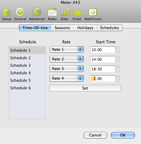

1) Total kWh is Forward kWh + Reverse kWh. To calculate Forward kWh only: Forward kWh = Total kWh - Reverse kWh
2) Yes you can set your meter to keep track of up to 4 Time-of-Use periods. You can make these settings by using the EKM Dash software. Once you have a meter setup, click "Edit Meter"> "Rates"
This is where TOU times can be setup. The EKM Dash will first read your meter to determine the TOU times that are set internally. If you want to make a change, change the values to the times you want and click "Set". The meter will ask for a password. Use "0" (zero: this is the default password, you should leave it at this, unless there is a compelling reason for changing it. If you change your password and lose it, there is no way to recover it.)
The TOU periods have to add up to 24 hours. There is no way to make the meter just keep track of 1/3 of a day. SO for example it could be set to start TOU1 at 10:00, then change to TOU2 at 14:00, TOU3 at 18:30, TOU4 at 2:00. I will attach a screenshot of this example:

I may have post this already but just is case
I am begging to get it, maybe
from the screen shot how doews it add up to 24 hours
Not sure what happens from 00:00 and 10:00 and 18:30 to 2

Hello Bill,
Thanks for getting back to us.
There is no break at midnight (0:00).
In my previous example TOU1 starts at 10:00, runs for 4 hours, then changes to TOU2 at 14:00, runs for 4 and a half hours, then changes to TOU3 at 18:30, runs for 7 and a half hours, changes to TOU4 at 2:00 and runs for 8 hours until 10:00 and keeps going with TOU1 again. This is a total of 24 hours.

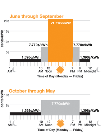

Here is an example I pulled from a utility website of what Time-of-Use could look like (our meters could keep track of how much was used in each time-of-use period):
You can see in this example, that there is no break at midnight. 11:59 PM and 12:01 AM the next day have the same TOU rate.
Now of course if you were on a utility plan like this (in the example), you would try to do everything you could to consume your power when it only costs 1.398 cents/kWh (at night) instead of 21.716 cents per kWh. Our meters would let you know how you were doing with this in real-time.
