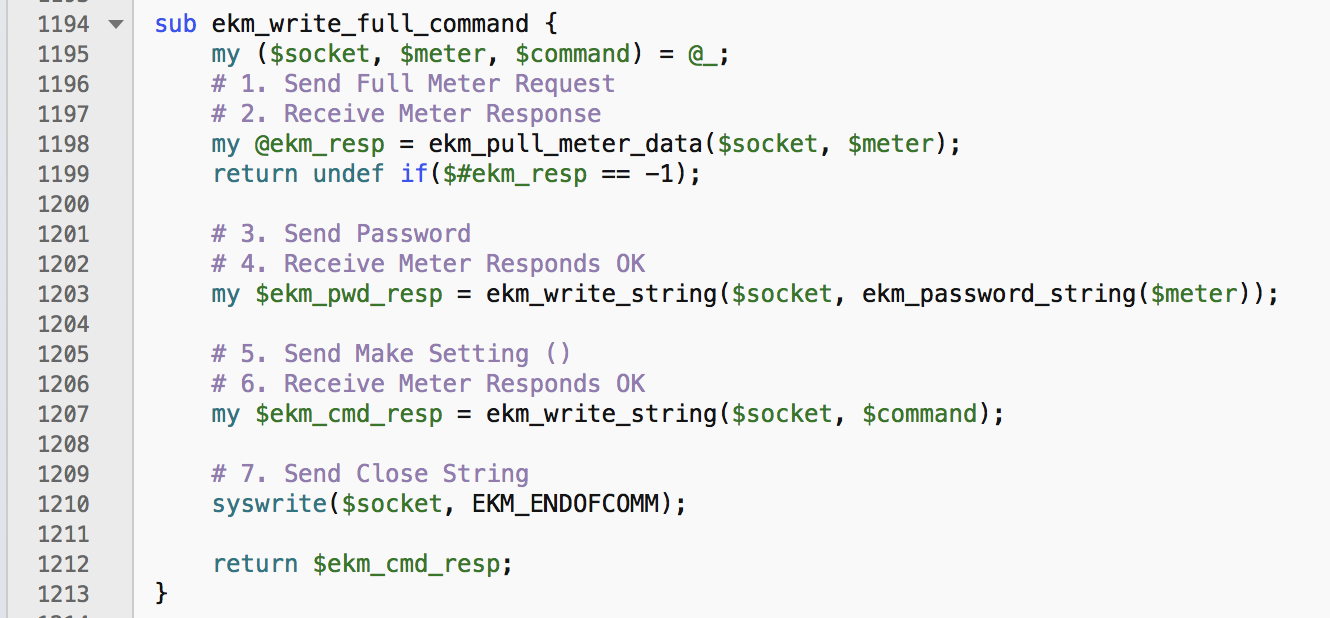

Im seeing the ability to read an Omnimeter Pulse v.4, make meter settings, clear resettable values, generate reports, etc. This is sweet!
I am not a coder, so I cant tell, but does this allow you to read your meter via USB Converter or EKM iSerial?
Just out of curiosity what hardware are you running this on?
Screenshot of some of the code:
Screenshot 2018-01-29 19.27.18.png (181.89 KiB) Viewed 44603 times
Again, thanks for posting, we really appreciate and encourage this kind of sharing.

It was designed for EKM iSerial, but easily can be converted USB Converter if needed. Just make the change for the $socket configuration to the serial port.
We are running this script on variety of Linuxes - CentOS on x86/x64 platforms, home run I have on EdgeRouter PRO ERPro-8 (http://ubnt.com/) and during development - on Windows PC with Cygwin or Padre IDE (with perl) installed.
