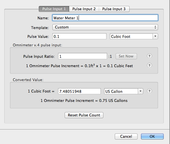

Please post a screenshot of the settings you have used int he Pulse Tab.
It sounds like you would like to have your Pulse Input Ratio set to 1:1 For every Pulse generated by your water meters the Pulse Count would then increment by 1.
If you are using an EKM SPWM-075 water meter I would setup your Dash like the attached image.
Screenshot 2015-03-26 09.08.44.png (51.86 KiB) Viewed 43753 times

Used setting u suggested but had to set Pulse Value at 0.0001 because Pulse Input Ratio is set at 1000. How can you change the Pulse Input Ratio? I saw in other comments that it is set in the software; I guess I really don't need to change it since I just adjusted the pulse value.
