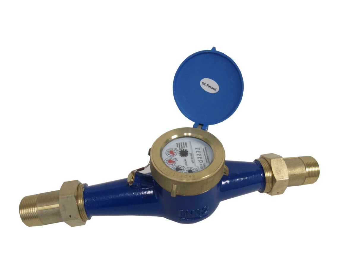

A question about straight-pipe requirements before & after water meters ---
Let's say you need 10 pipe diameters before the meter, for a 3/4" pipe that's about 8" of straight length.
Can you/do you count a union-fitting meter adapter piece as part of that straight length? Or do you need an additional 8" of straight pipe before the meter-adapter union fitting?
Here's a photo of what I mean by "union fitting meter adapter" --- the brass pieces attached at either end of this blue-colored meter.
Let's say you need 8" of straight pipe attached to the inlet of this meter. Do the 2.5" to 3" long brass fittings count as part of that 8" minimum length, or does there need to be an additional 8" of straight pipe before the brass adapter fitting itself?
Re: Temperature limitations
Posted: Mon Feb 10, 2025 9:33 am
I think you can include the union in the straight pipe part of the calculation.
