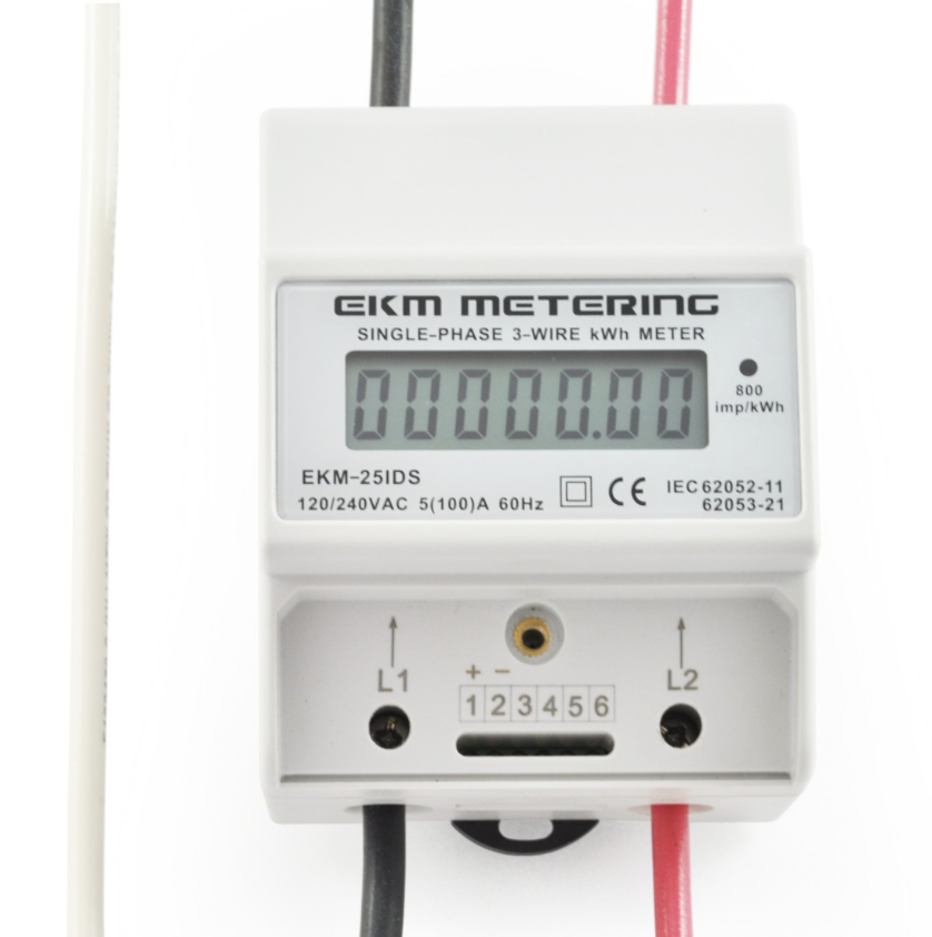

So i have a 240v 3 wires system (2 hot 1 neutral) sub-panel on my shed, i had do research and bought the EKM-25IDS one.
My question is do i need CT for the installation? or just simply hook up directly the wire from the meter to each leg of black and red hot in sub panel?
A picture will mean a lot too :)

The EKM 25IDS sounds like it could be the correct meter for you if your wires are under 3/8" diameter and you are metering less than 100 amps.
You do not need to purchase external CTs with this meter. The EKM 25IDS already has the CTs internally. When you pass your wires through the tubes in the meter body, you will be passing them through the internal CTs.

Here is a photo showing the wires that are being measured passing through the body of the meter:
